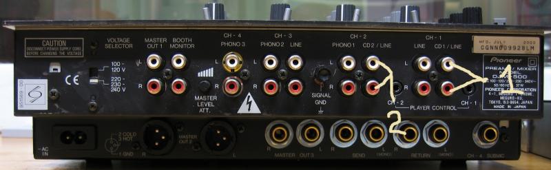

To make sure that the Crossfader is working. Move the " Crossfader assign switch A " to 1 And the Crossfader assign switch B to 2. Now connect t5he CDJ left deck to CD1 of the CD1/Line and the Right cdj table to CD2 of the CD2/line
.jpg)
