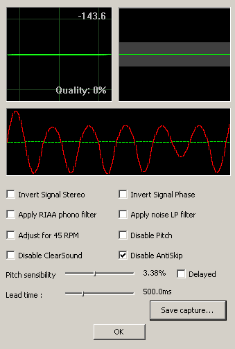

Has anyone encountered this?
Switched cables, CD players and soundcards still with the same result. Any suggestions woudl be helpful, thanks guys.

Experiencing the same problem since 2 days after upgrading to V7.0.2. Tried all means with no success. Unlike the previous versions no AUTOCONFIG for TIMECODES
Using WIN VISTA, MAYA44, ASIO. Any help will be highly appreciated.

u guys followed this? http://www.virtualdj.com/wiki/TimeCode%20Config.html
Posted Sun 09 Jan 11 @ 7:37 pm
farhanashraf, thanks for your help. I tried applying the information from the link you recommended but no changes in the timecode configuration. It still shows 0% and delayed instead of smooth. I'm totally helpless. Got 2 gigs over the weekend. I had to reinsaste my comp last week thus downloading the new VDJ V7.0.02. Will real real appreciate further help.Thanks.

^ did u try swapping rcas, needles , and cables n what not?
Posted Tue 11 Jan 11 @ 5:36 pm
Yes i did. I do use Denon 1000 CD Players...

Something interesting I switched the mode to Serato CD and all over a sudden the time code was running BUT at 3%. No reaction when I select VDJ CD mode for timecode. Pretty weird!! But still after a couple of songs the timecode stops running ie I have to revert to using VDJ directly from the laptop. Any Idea?
Posted Mon 17 Jan 11 @ 1:57 pm
I'm having the same problem. The timecode on the new serato vinyl seems to randomly stop. I don't know what to do or where to go with it from here. Its super embarrasing when 200 people are dancing and music just stops, randomly.
