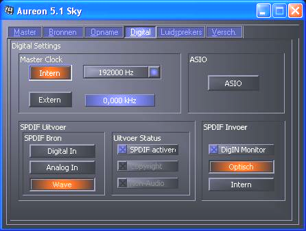

@groovindj: Although I think you are right, I understand that Klaas is missing your point. If the card is working with the old audio-setup, you might expext it also does with Advanced setup, no matter how old that card is.
BTW: In the manual I found 1 clue that the card supports ASIO:
@Klaas: I do recognize your problem, because I've had similar issues with an older Maya-card. It seems (not confirmed) that Advanced Setup is conflicting with older ASIO-versions. The Aureon Sky-card is no longer supported by TerraTec, so the last decent ASIO-driver is probably several years old now. Because I don't work with 4 decks I just use the old setup (like you have done so far).
I think you've got 2 options: If you can spend the money, go get yourself a professional audio-card. Here at home and in the studio I use a M-Audio FireWire 410, which I can configure anyway I want. So no problems with Advanced Setup. But it was a €400, + investment...
The second option is to install ASIO4ALL. (just google it) Install and configure it for your card. It's free and a second choice-option but it might help you to configure your card in Advanced Setup.

@Martin,
Thank you!!! This helps, ASIO4ALL works!
So it must be that Advanced setup is conflicting with the (older) ASIO driver from the Terratec Aureon it self.
See you on the Dutch forum. :) (schrijft makkelijker.)
