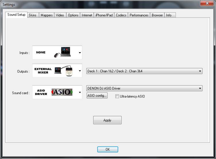

Yes, I am using the DN-X1600 as sound card and the DN-S3700’s as controllers.
1- After hours of work I solved the deck crisscross issue, I have to start the right deck first or they will crisscross left to right. Left deck ( ch 1, all) with right deck ( ch 1, all).
2- Latency issues
3- Auto loop will not stay in sync, every time the loop cycles the right deck falls behind SAME TRACK ON left deck
4- Sometimes the left deck platter will stop turning even though I can start and stop the deck
5- Big delay between the times I push play and when the track starts
6- I play a track and without me touching the decks the sound will cutout or slight scratch like, sound as if someone touched the platter
7- After I restart left deck when it lockup, the right deck will go nuts. I am thinking what happens when I am at gig and this happens?
8- I think since I started using the DN-X1600 as sound card things got worse.
I am strongly thinking about returning the equipment and going back to my old system. Can someone help me with this; I see videos on YouTube with the same equipment and software working properly.
1- What do I need to do to make this work?
2- Do I need external sound card?
3- Do I stop using the 1600 as a sound card?
4- Do I use Midi or hybrid? If hybrid, how would that work? When I pick hybrid mode they don’t connect vdj? How do you change the settings to make it work in hybrid?
5- Time codes or no time codes?

I am experiencing the same issues, Yesterday Virtual Dj crashed at least 20 times while I was in Hybrid mode. For whatever reason whenever asio pickup the 1600 in hybrid mode it does not pick up the 3700's. In regular midi mode everything works great, but what the point of having hybrid mode with a native player and you cannot use it. I would like if any who has figured this for their assitance.
1. Is the 1600 suppose to show up as a sound card in the drop down menu in the soundcard selection in Vdj.
2. How do I route the channels in the 1600 correctly to get the sound working while using my 3700 time code in Hyrid mode che.
3. Do I have to change any settings in USB-A USB-B mode to assign channels.
4. Please post pictures video and clear information if you can my experimentation with this has been really hard. Thanks
