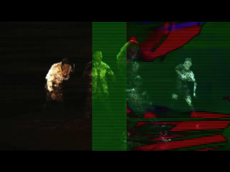

Posted Sun 16 Jan 11 @ 12:21 am
ill retry later with the pic
whats happeninh is i have lines on the right hand side of the screen every so often
picture this, split the screen in half from right to left, and on the right hand side of the screen tale the image and put horizontal lines missing the red of the image, im running mp4's
any ideas
any ideas
Posted Sun 16 Jan 11 @ 2:15 am
heres the pic i hope
Posted Sun 16 Jan 11 @ 2:20 am
sorry windows xp
Posted Sun 16 Jan 11 @ 2:21 am
You just installed DirectX 10 on Windows XP?
Posted Sun 16 Jan 11 @ 5:07 am
i think i got it, turned off the hardware acceleration and it seemed to do the trick
Posted Sun 16 Jan 11 @ 11:45 pm
