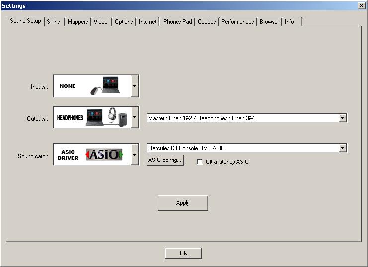

Some of you may have seen my post regarding setting up my RMX with VDJ in a club and how to connect it all up... now I have put my worries about that to one side I would like a bit of advice about setting up the software correctly.
Primarily the sound setup page (input, output & Soundcard)
I will be using the RMX as the soundcard routing via a DJM800 into the soundsystem as I have never set it up this way I'm unsure of the exact settings I should be using. When I have played at house parties and the like this is my usual set up as I find it the easiest to use:
RMX - Laptop via USB
Laptop to Stereo system via jack to phono cable
Sound setup page: No Input, Single Output, Soundcard Simple
I have toruble with getting a cue track in my headphones this way and I've never really had the time to mess about at home to figuire it all out properly.
What should I be setting Output & Soundcard to with the setup I intend to use in the club?
at a guess it would be Single output & Hercules RMX as the soundcard... or should I be using asio driver?
Any help appreciated.

That is the wrong way to setup the Sound Setup tab of the Settings dialog box.
Set it up like this:
Craiguk wrote :
I have trouble with getting a cue track in my headphones this way and I've never really had the time to mess about at home to figure it all out properly.
Headphones should work now if you set it up as above. Use Outputs 1 - 2 from the RMX and connect to a stereo Channel on the DJM800.

Look at the above pic.
