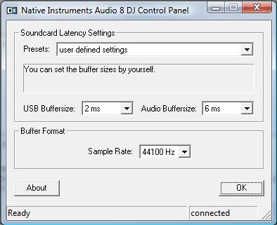

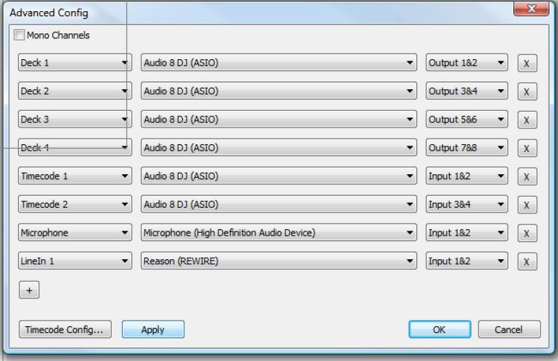

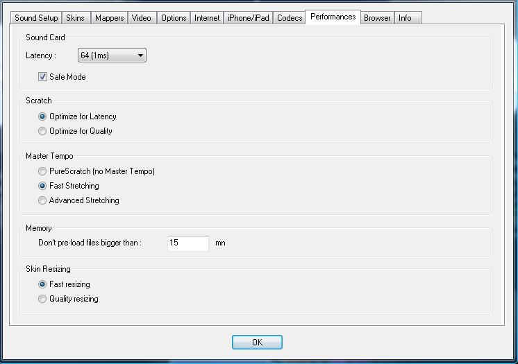

Ok here are my settings, I use 2 timecodes with 4 channels (all on their own channel), for timecodes I use Serato CVO2's Red and Black on Tech 1200's with Shure M44-7's.
My settings in the Advanced Config
My settings in the Audio 8 DJ ASIO Settings page
and my settings in VDJ.
With these setting I have to becareful when playing videos cause my settings are so high. I've only run into a problem when I have a few video effects running, playing 3 decks at the same time while tryin to load a video on the fourth deck. Other then that its perfect!!
I'll try to get a video made soon and post it so you can see I'm not BSin here, lol!
Good Luck
Huey
Good Luck
Huey
Posted Wed 24 Nov 10 @ 2:39 am
Thank you.
I'm gonna try mine just like that. Maybe i had eveything too high. Cause you have vdj at 1 ms. Thanks for the screen shots. Preesshh!
