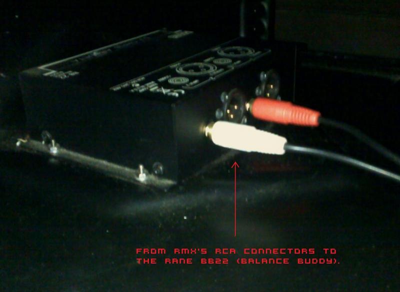

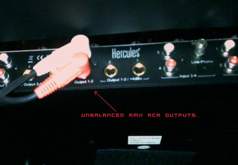

Some clubs have neither, maybe just an amp and speakers. If that's the case, you'll have to take your RMX's unbalanced RCA connections and balance them before you go into the amplifier's 1/4" balanced inputs. Why? Well, if you connect unbalanced RCAs to balanced 1/4" jacks you will get hum or buzz.
So how do you balance an unbalanced signal? Rane BB22. Below are pics of my setup. This is how I connect my RMX's unbalanced connections to my amplifier's balanced connections.
From the Rane BB22 outputs, you connect a pair of balanced XLR to 1/4" phone plug cables (most amps' inputs are 1/4" balanced jacks) to the amp's input jacks.

I use Outputs 1 - 2 from the RMX. They will also output the Mic.
Outputs 3 - 4 are for the Monitor speakers; they output the same as the Headphone jacks.
