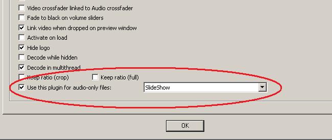

You can also use the Slideshow plugin, with slideshow option set to off. Create a folder with just the image you wish to be shown when you play audio. Do not activate the plugin, just click and check from the config menu - video - Use this plugin when audio-files only .. select the Slideshow plugin
