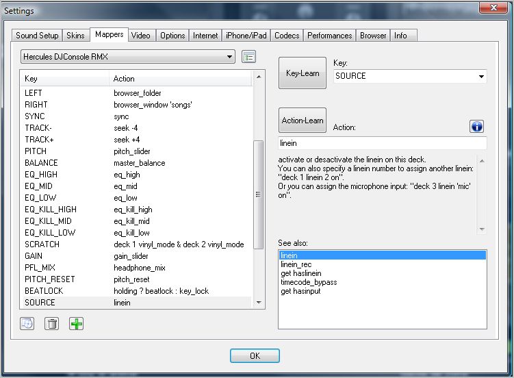

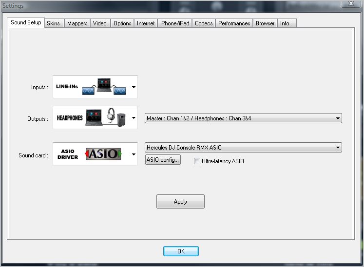

Then I checked the Mappers and noticed that it was on timecode_bypass. I changed that to linein and also in Sound Setup, I changed None to Line-Ins and finally music when hitting the Source button.
It looks like that version 7 expects this for the RMX, see screenshots:
