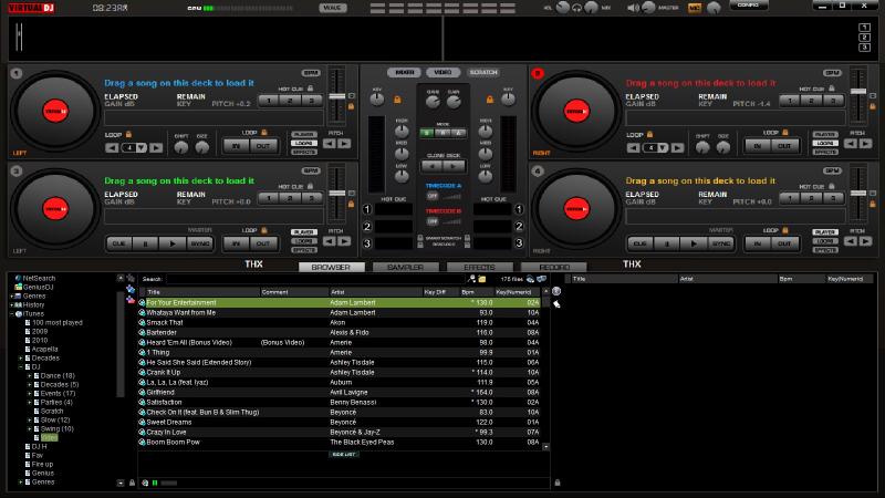

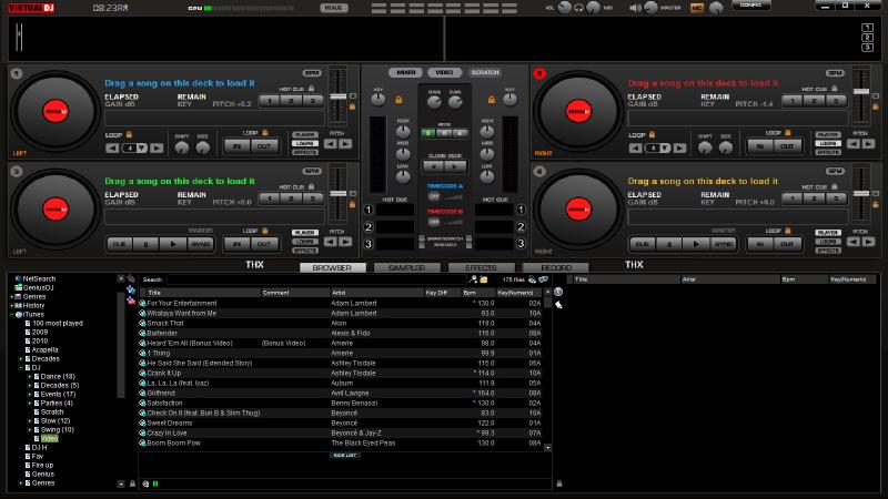

So, as I was testing these scripts again. I realised that the other Load script from my first post, still does have a problem and I believe this to be a bug too.
When I use: LOAD = holding ? unload : load it apperas not to have a problem when VDJ starts up if there is no music in my default filter folder (the one that VDJ opens up into). You can see in this picture that my bottom filter folder shows me songs that have not been scanned yet. That is also the filter folder that VDJ defaults to when VDJ first opens. Notice that when only when there is music in this list, VDJ will load the first song in this list to both decks AND the side list!
This was taken right after VDJ fired up. The only script that make this happen is LOAD = holding ? unload : load. If I make this button just "load" like it is default, this deos not happen. If I have scanned my library and there is no music in this list, VDJ does not do this on fire up.
Automix, please take notice/respond. There deffinately seems to be an issue here.
***EDIT*** I can easily reproduce this on every VDj startup, but my NS7 has to be on for this script to fire up. If the NS7 is off, I don't get this problem on start up.

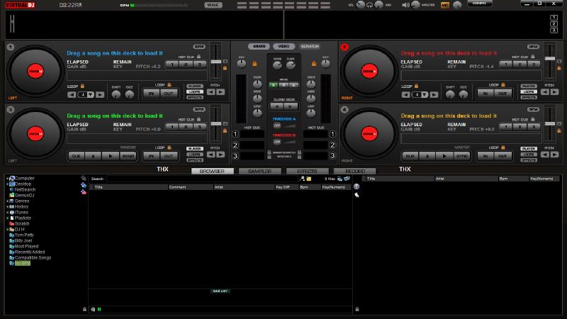

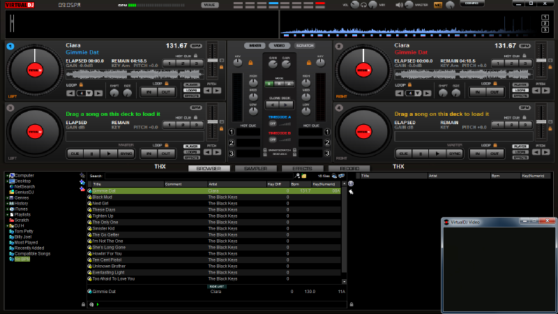

The other script LOAD_PREPARE = holding ? automix : prelisten cuases the preview window witch normally displays a "Play" symbol at start to display a pause symbol. Shown here (compare to picture above witout this script).
In this picture, you can see that I can browse playlists all that I want. Preview is still showing a pause sign, but nothing is playing.
Last, when I select a song, it imedately starts playing in preview whitout me doing anything other that left clicking on the song or scroling to it on the NS7 scroll knob.
I hope these help explaine how to reproduce this bug now.

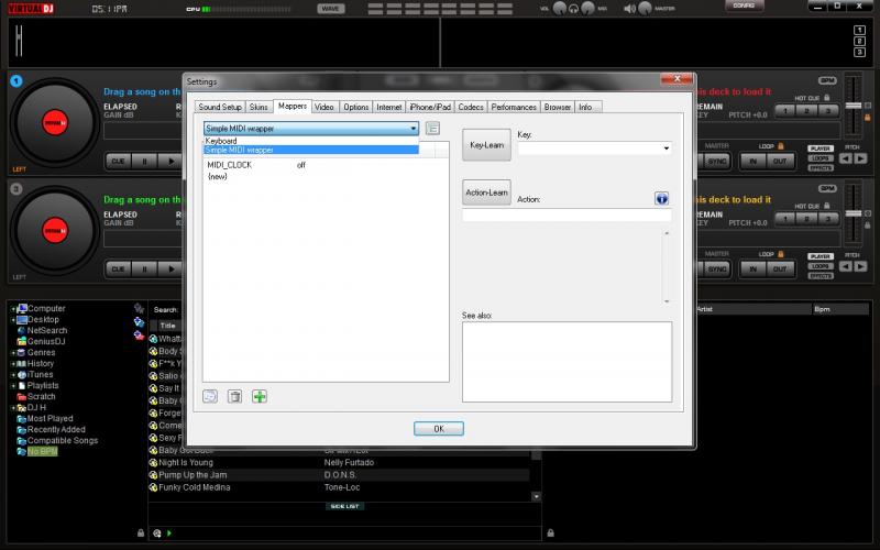

HEy Dhoude. Everytime I try to take a snippet of my deck assignment sub-menu, it goes away when I click on the snippet tool. Any suggestions on that? But just so you know. Even without the NSFX connected via USB. The "numark_nsfx" along with the "NS7" deck assignments are there in that sub-menu. When I actually connect the NSFX, then a second deck assignment titled "nsfx" appears. Giving me a total of two for the NSFX. Pretty weird man. And I am not able to get effects control with the NSFX on decks 3-4. Are you able? Thanx man.
Posted Wed 10 Nov 10 @ 3:28 pm
Odd, miy sub menu is empty when they are not connected. So the NS7 and the NSFX is not there on my laptop when disconnected. Somthing is up with your setup and I have no idea what, as VDJ should not say it is there, when it is not.

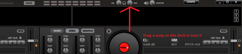

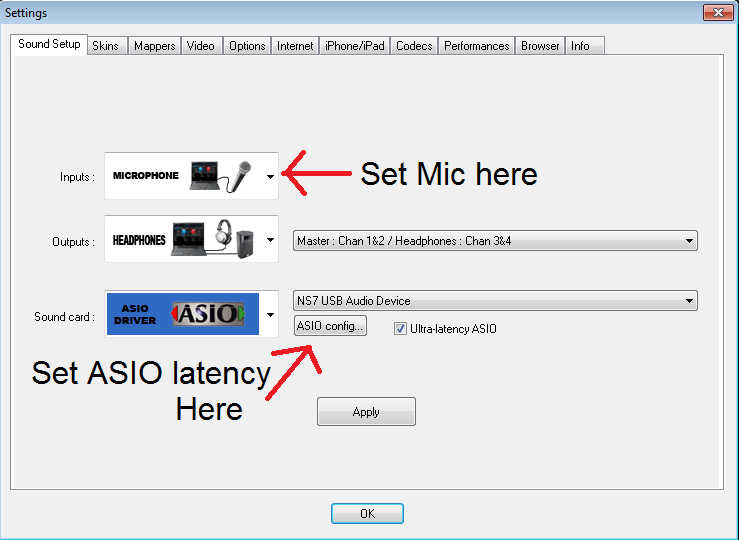

oh my bad sorry bro... ok so with the ns7 connected to vdj 7.02 my headphone mix is pretty messed up it doesn't work right at all. i have an hp dv4 laptop, its vista 64bit. and idk if i'm just not doing it right or what but when i scratch it sounds like ass. what should my options in vdj be, and what does the mapping need to be to fix the headphone thing? and isn't the mic input supposed to work with the ns7 through vdj now? that doesn't work either... and also whenever i try to save a playlist in vdj it saves the name of the playlist but not the songs in the playlist... any clue on what that's about?
Posted Sun 06 Feb 11 @ 5:02 pm

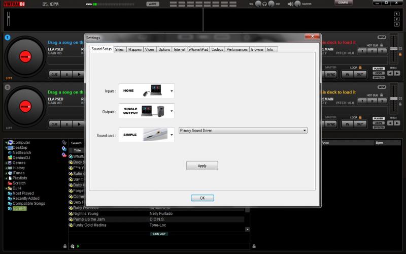

Set hedphone mix to desired position to fix the issue (see big red arrow).
The mic works when you set it up as an input. Do this under settings and then sound card tab.
You need a super fast PC to get this board to sound perfect (scratch, etc). The second red arrow marks the ONLY place you shoud set your latency. Set it to 512 and that should clear the sound up a bit. If you need to test if it is the PC speed, turn key lock off and it should sound better too.
Last, it may be me, but I swear when I had a slower PC that setting the record spinning to 33 RPM (under settings / options tab) helped. Less rotations = less data = slower PC has less to process??? Maybe?

sweet thanks alot. but what about the whack headphone mix?... it doesn't fade between ch1 and ch2 like it used to...
Posted Tue 08 Feb 11 @ 11:54 pm
Read it again, it was the first thing I addressed. It is the headphone mix knob. Move it all the way right (counter clockwise) like my picture shows.
