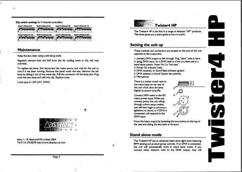

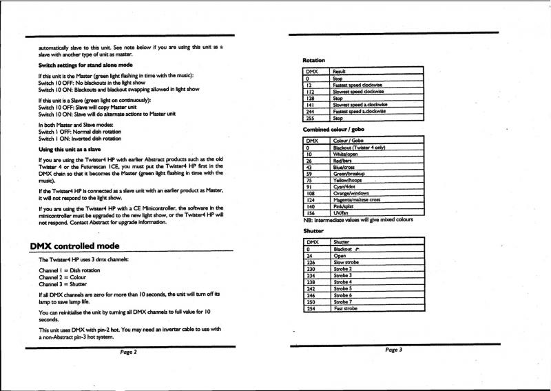

I'm trying to sync these lights up so that move in time but am not sure what the dip switches should be, I have the manual but it doesn't seem to cover this.
Can you see from the images?
Posted Sun 24 Oct 10 @ 7:11 am
stadard abstarct if you are just linking the 2 lights together you leave all dip switches off and use a xlr cable to link,if you want them doing opposites which gives a better light show you swith on dip switch 10 on the slave unit, also swithch 1 on will invert dish rotation on the slave unit
Great thanks Kev, although I suspect all units are faulty as i've already tried this setting.
