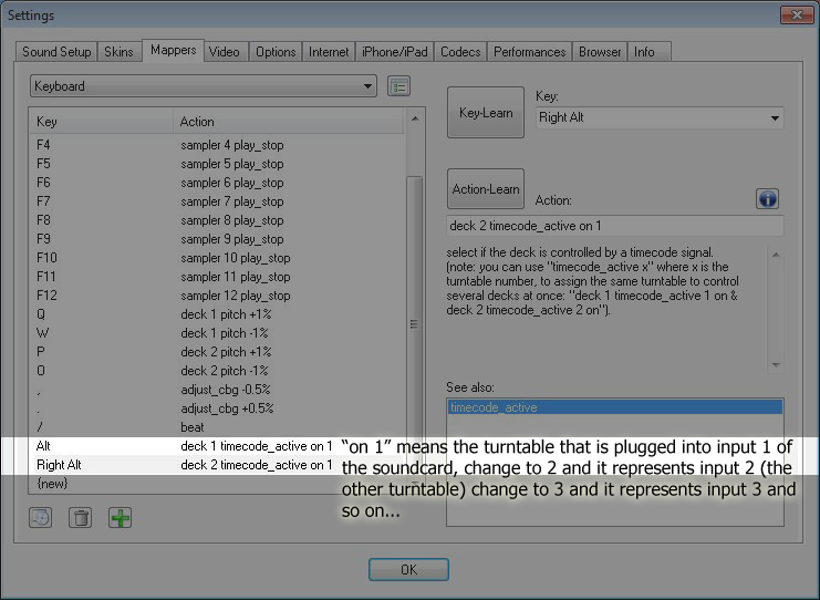

this is what i have set up
the two ALT tabs (one on each side of the space bar) on my keyboard represent the 2 decks im using.
i have set it up so that when i hit that key i select a specific deck, this allows me to back and forth between decks, the following is how i configured my keyboard mapper....

this is a solution but i really liked how it worked before in vdj 6.. how it automatically set the new track as the active time code. it shouldnt be too hard to change some kind of setting to do this, right???
