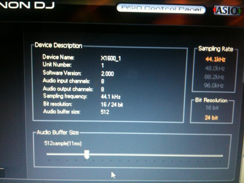

Yeah I have it set to usb B at startup. One thing I am noticing though is that even thought he mixer Sampling rate is set internally to 44.1khz (which I switched in USB A Mode) the denon Asio Program on my lappy still says its set to 96.0khz. Im thinking this is why its giving me the error message in VDJ. Gonna reinstall a couple times and see what happens

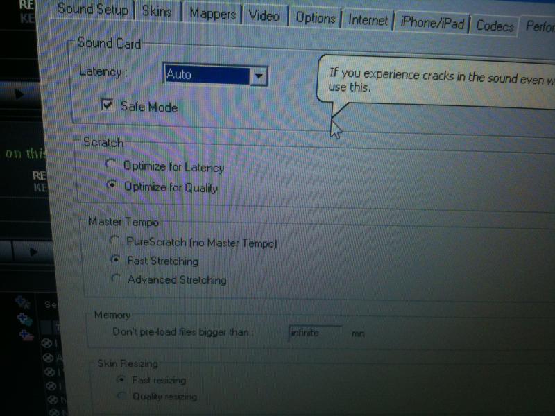

What are your settings in the "Sound Setup" tab?

Well I messed with this thing for 7 hours yesterday trying every possible setting. It works if I just play Mp3s through the channels with all the source selects as USB. I could get it to Work perfect with one timcode with a simple setting of 2TCs and external mixer. only the left TT controlls deck two seeing as how CHannel 1 on the mixer itself cannot function as phono. But sound quality and signal are perfect.

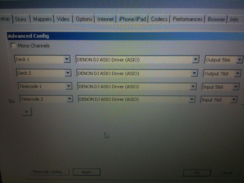

So here is where I am at now. When I set the decks and timecodes up the TC signal is really distorted, but the decks are playing correctly in respect to A, B and TC 1, 2. Sounds like a latency Issue, but Ive tried multiple settings within the Dennon Asio and Within VDJ Performance Tab. Eventually the sound quality is deteriorating so bad that my Laptop BSODs and says Bad Pool Calleror VDJ Freezes and Crashes.
-On A side note When I set up the decks and TCs in the advanced config tab, as soon as the needle hits the TC the ability to select the dennon asio card will disappear from the drop down tab and all my Input and Output channels will revert to 1&2 without the ability to change them to 3&4,5&6,7&8.
-Here is a pic of just a basic setup trying to get 2 decks functioning with timecode, right after I used these settings the sound quality was good for about 5 sec then started skipping then my lappy BSODstating Bad Pool Caller" Again.

There has to be something funny about your settings, because my DN-X1600 is working perfectly with VDJ...then again, I'm using a Mac. I tested the timecode inputs and I got a strong signal in VDJ. I was actually using real vinyl because I didn't have a TCV, but this should prove it works just as well.
If I recall correctly, VDJ7 should now support 24bit audio (previous versions didn't), but just incase set everything - both mixer's utility-settings and ASIO-settings - to 16bit/44.1KHZ. Also, make sure you have the same latency setting everywhere and use that same value in VDJ settings instead of Auto.

What you said about changing to 16bit audio how do I do this?

Utility --> System --> FS (in DN-X1600 settings)
You can get 4 channel output in VDJ by selecting the Advanced audio config:
Deck 1 - Denon DN-X1600 (ASIO) - Output 1&2
Deck 2 - Denon DN-X1600 (ASIO) - Output 3&4
Deck 3 - Denon DN-X1600 (ASIO) - Output 5&6
Deck 4 - Denon DN-X1600 (ASIO) - Output 7&8
...and when using TCV you have to replace the former OR add these - not sure, don't have TCV so I can't test it:
Timecode 1 - Denon DN-X1600 (ASIO) - Input 1&2
Timecode 2 - Denon DN-X1600 (ASIO) - Input 3&4
Timecode 3 - Denon DN-X1600 (ASIO) - Input 5&6
Timecode 4 - Denon DN-X1600 (ASIO) - Input 7&8

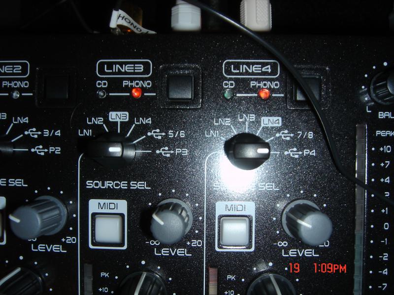

Also, the matrix-switches (=source-sel) need to be set into P1/P2/P3/P4 position for VDJ to detect TCV signal...or at least with Mac, that's how it seems to work.
