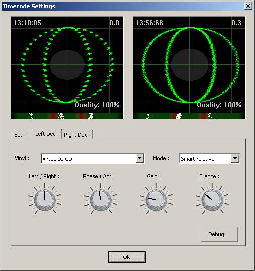

In VDJ Config Sound Setup I choose Timecodes, and that's is what I have in the Timecode config:
Both decks have 100% but the right deck had a very distorted sound and was not useable. The circles are full lines on the right deck and dotted on the left. Does that mean anything?

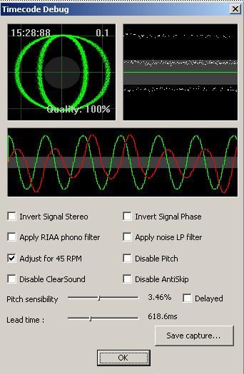

Here's the Debug window;

1) With a Pioneer CDJ player, I suggest your set the input level in DJ Console Mk4 control panel on Boost.

I din't try Boost, but why is 1 deck OK and the other not then with my Pro settings?
