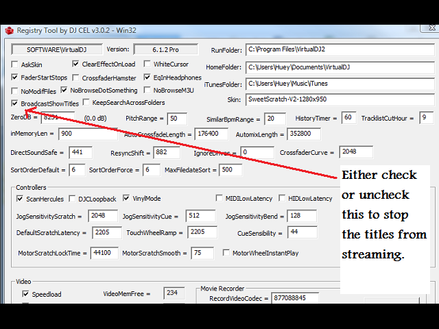

#2: I suspect the website does not want the artist name/songs pushed on the stream so listeners can see the name of the artist/song on the play window (like iTunes). Is there a way to disable pushing the artist name/song in VDJ?

Well I cant really answer your first question cause I have never used 1 let alone even seen 1 in person, lol! But to stop the titles from showing you can download the, http://www.virtualdj.com/addons/2170/Registry_Tool.html. Look at the pic
Hope that help

Huey,
Many thanks the registry magic did the job!
