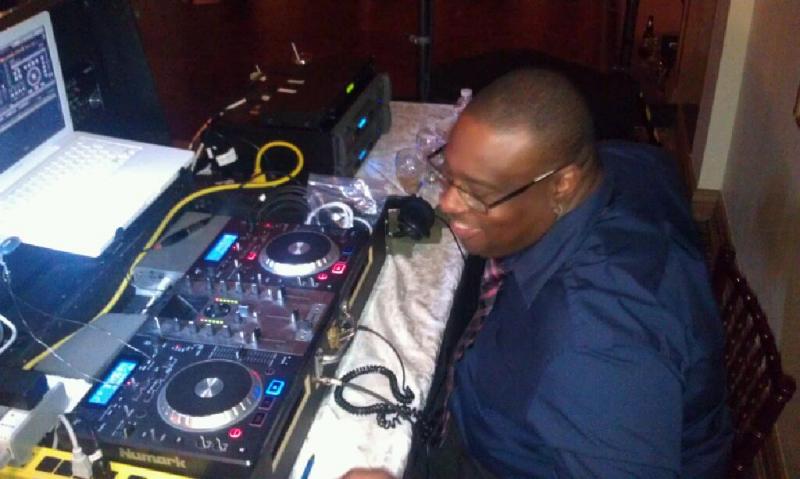

The question, how do you fade from 1 -> 2? The software crossfader stays in the middle. You mix with the Mixdeck mixer and use the decks to control the VDJ decks for looping, pitch bend, play, pause, hot cues etc. Press play on deck 2 & fade over to deck 2. Super simple.
It does work well with VDJ. I've changed in the middle of a show to play a CD & even a jump drive, then change 'source' back to MIDI when done and it goes right back to VDJ. For best results, set both decks to MIDI, then open the VDJ program. They will sync together and the display on the Mixdeck will look correct.
