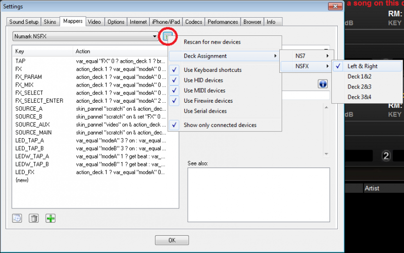

mine works but not all the time, i have to restart vdj like 10 times to get it to work. each time the the keys do different stuff.
it seems like i will have no luck getting the right answer
Posted Fri 15 Jul 11 @ 7:04 pm
Hey man, it sounds like the NSFX is not set up for the right decks. VD7 can put (and has in my case) the NSFX as a seperate controler for other decks 3 & 4. Try this:
Go to the VDJ config menu and then the mapper tab.
Select the NSFX for Deck 1 & 2 or Left & Right (like I have). It sould work correctly now.
