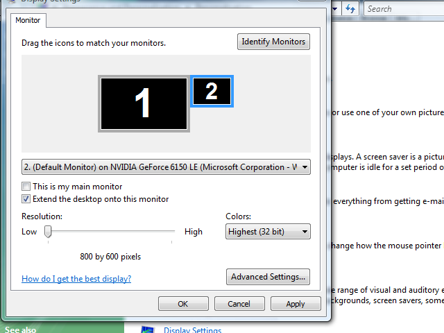

Just use whats on your laptop. You said your laptop has the standard video monitor output and a hdmi video output. Plug 1 end into the hdmi on your lappy the other to the tv or monitor your using. Then right-click on your home screen and select display settings. Then a window should open that look like this,
Then click on the screen with the #2 on it, next click the box that says \"Extend the desktop to this monitor, select your res and your done with that part, SAVE AND CLOSE.

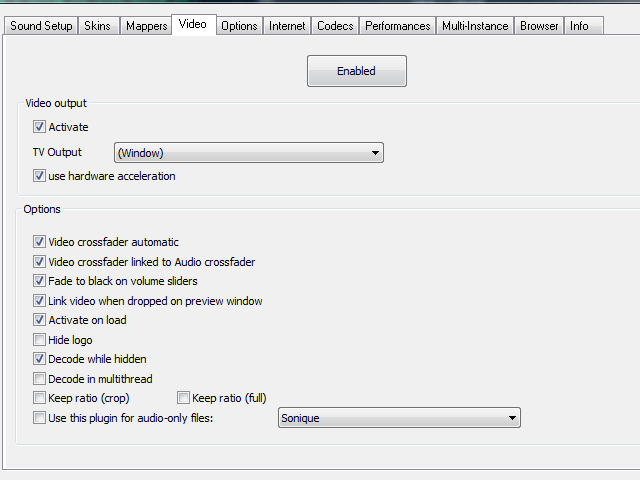

Next open VDJ and click on CONFIG then hit the video tab it should look like this,
Next to where it says "TV OUTPUT" click on it and select your video card and then click "activate" next hit ok. Your other screen should now have the VDJ logo at the bottom of the screen and your good to go. Start mixing video.

Ok so if your getting a border your not doing it right. In the drop down box next to "TV OUTPUT" what did you select? As far as looking clean I would say thats a combination of factors such "Video Type (HD), TV or SCREEN your using, and what resolution you have it set for on your computer".
Could you take a screen shot of your video settings in VDJ after you have them set and video is outputting??
