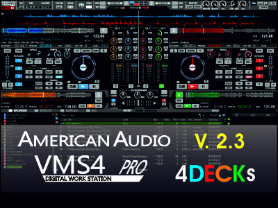

Ok i uploaded a new version
Download Link
https://virtualdj.com/addons/11940/American_Audio_VMS4_Pro.html
In this version the Fx parametrs are toggling according to the default mapper BUT you have to make these 2 adjustments to the default mapper according these sliders to work and toggle.
Key : FX_SHIFT
action : toggle "$fx_shift"
Key : FX_SLIDER
action : var "$fx_shift" ? effect slider 2 : effect slider 1
The $ mark makes the var global, which means that when you toggle the prmtr to the left deck, it will toggle the right too.
I tried to fix this without changing the mapper, but it was impossible, so if you use the default mapper you may find this update useful. If you use my mapper, then you dont have to download this one. It's not necessary.
Download Link
Key : FX_SHIFT
Key : FX_SLIDER

I updated the skin according to the default mapper, and this is what i stated with bold letters.
I will make another version 2.3 with 2 different effect panels to choose from, so everybody will be happy. :D The second fx panel (the new) will have 2 fx sliders view just as you proposed.
It will be ready in the weekend.

It was sooner :p
Updated
American Audio VMS4PRO ver 2.3
Download Link
Ver 2.3
For more infos about the new Slip Mode and ScratchEffect Mode read here https://virtualdj.com/forums/137529/Hardware_Technical_Support/American_Audio_VMS4_Mapper_FULL_v_2_0.html
Enjoy the new features !
Updated
Download Link
Ver 2.3
- Added Slip Mode & ScratchEffect indicators (You need my mapper ver 2.0)
https://virtualdj.com/addons/12221/American_Audio_VMS4_Pro_Full.html - Added secondary effect parameters view (with both sliders viewable)
- Changed the Loop Double and half order. ( i wonder why no one noticed that !)
- New color (purple) for video buttons and icons
