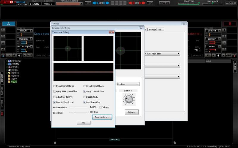

I used to use the RMX alone and recently upgraded my setup to get into turntablism. I am needing some help because I am not sure if everything is the way it should be. Thanks for taking a look...
My setup

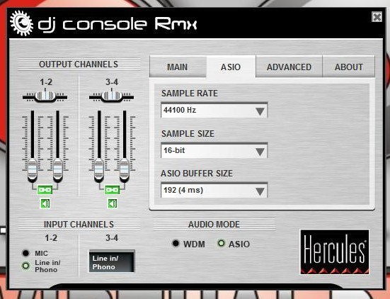

RMX ASIO buffer

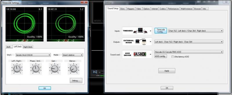

Timecode Signals L and R

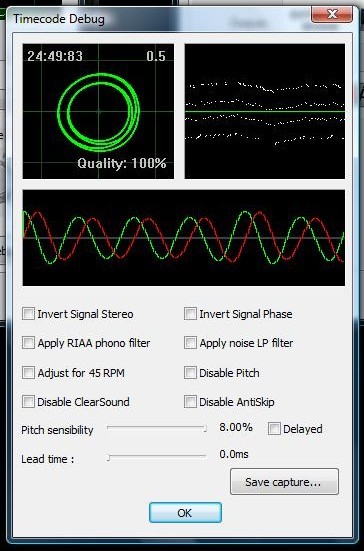

Left Debug

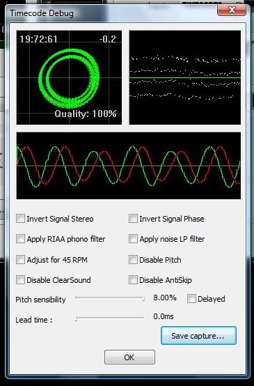

Right Debug

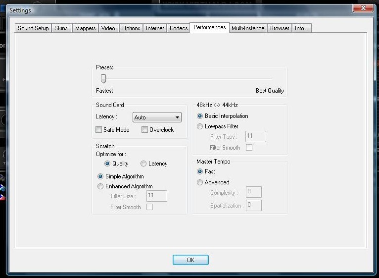

Performance Tab

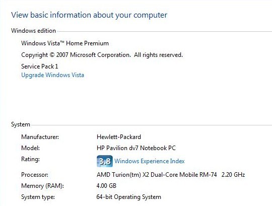

PC Specs
Every 5-10 seconds the Quality (#s just below the timecode signal) drops to 30% for just a split second and I think that leads to the speed indicator (numbers top right of timecode signal) fluctuating +/- 1.0
This makes the song/videos play inaccurately. It almost sounds like I am pitch bending the songs/videos. Is there anything in my set up that I may have overlooked or any suggested hardware that I could swap out? Any help is appreciated.

Start by playing around with the ASIO buffer size. Sometimes a step or 2 can make a big difference.
Posted Fri 06 Aug 10 @ 2:35 pm
And adjust the silence knob by double clicking on it
Posted Fri 06 Aug 10 @ 6:05 pm
Ignore my pitch sensitivity settings, but check all the boxes on your system that are checked.
Michael
Posted Sat 07 Aug 10 @ 3:34 am
Thanks for the replies.
I have done everything suggested here and it has made some improvement. I have recently switched back to CV02 Side A, along with your suggestions and everything is woking 99.9%.
Thanks again!!
