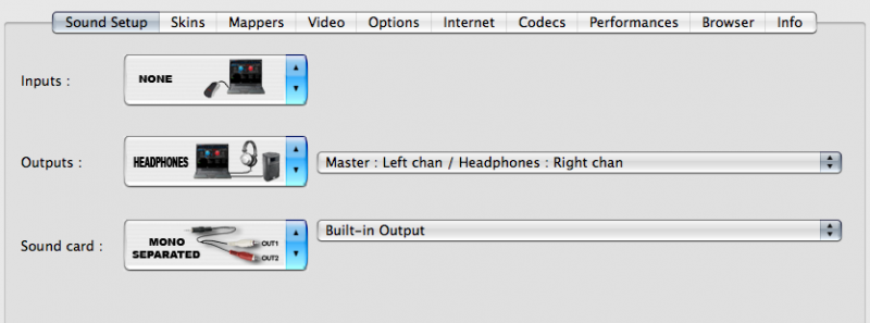

You can run in mono separated. This will NOT be a great sounding solution, but it will work.
You will need to get some wires/adapters from a Radio Shack or Guitar Center type place.
1. 1 Headphone mini plug to dual RCA Female - You will use this to split the signal into Right and Left/Headphone and Master
2. 1 RCA Male to 1/4" Headphone Miniplug - You will use this to plug headphones into
3. 1 RCA Male to Dual RCA Female Splitter - You will use this to plug into mixer/amp

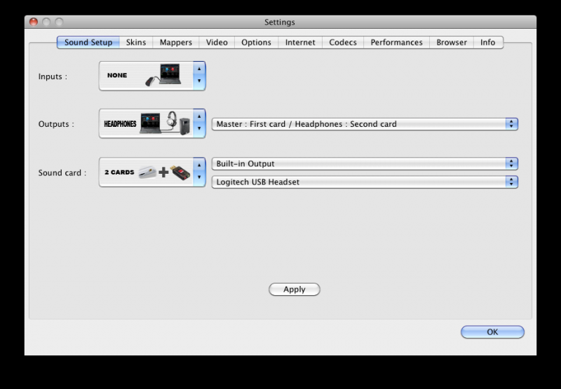

I have no issues using a cheap Logitech USB stereo sound card for headphones as the output for the headphones and the internal sound card to go out to the speakers. I use this when I don't want to lug my external decks, mixer, and multichannel sound card.
I would set it up as a two sound card setup and use the internal and external sound cards.
The Logitech USB is natively supported in OX X and can be purchased at Best Buy with several of the headsets. It takes a standard 1/8" plug so you don't have to use the headsets that come with it.
Does the external sound card show up on the Mac in Audio MIDI Setup?
When you choose Sound Card in VirtualDJ setup and set it to multiple cards, do you have the option to choose the two cards?
Make sure you get audio from the system out of the USB sound card you purchased. It may not be a VirtualDJ issue. It may be that it is not supported on the Mac even though it lists it on Amazon as supporting it.

This is how my settings look for a USB sound card and the internal sound card.
