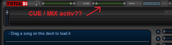

what skin you use ? do you have cue / mix adjustment ?

I have the latest version of virtual DJ and not sure which skins your talking about, sorry, I use also mix lab 3 once in a while

Hi and yes I did finally figures it out after I tried the cue/mix skin like you had told me about as I was playing with my total controller and went and change my skin to the cue/mix and saw the cue on top and I had to adjust the level, everything is great now, Thanks a lot for your help appreciate this... OMG was I dumm or what LOL , the skin I was using wasn't showing it. Thumbs up for you guys on VDJ. your the best!
