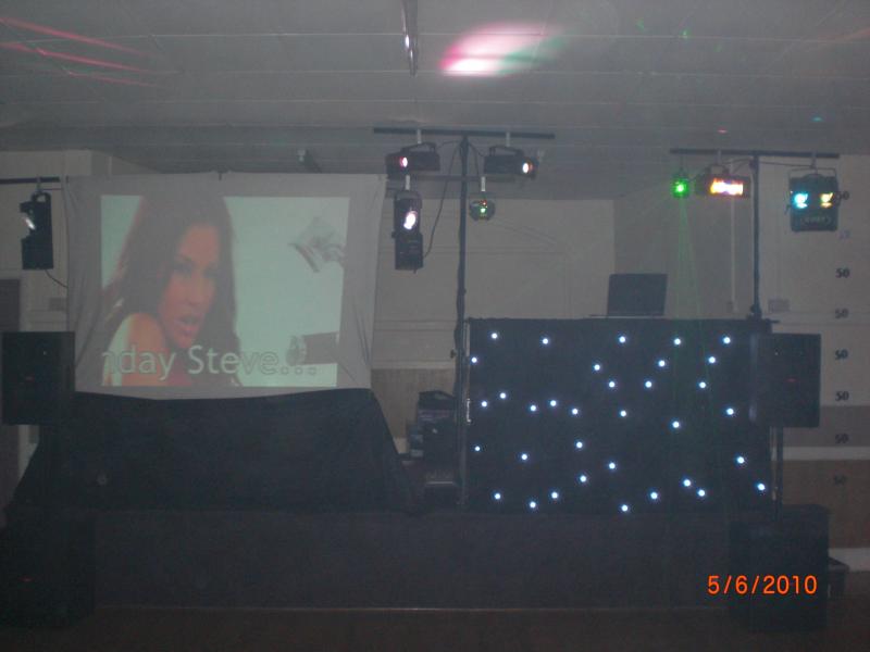

Well even though I had a projector failure I managed to borrow another one for the evening. The setup isn't perfect, but for first time out I think it looked OK.
Everyone commented on it, that they hadn't seen this anywhere else locally and especially enjoyed the slideshow between music vids of the birthday boy!!!
The screen is made up from my two t-bar stands but I've swapped the t-bars from the deck stand with those from the t-bar stands...
The screen is a 1.5m x 2m piece of lycra which cost me £14 ($20). The black skirt was material I already had. It is held up with simple tablecloth spring clips.
It obvisouly needs work. There was nothing to hold the skirt up in the middle so it drooped, and it also got a bit crowded between the deck stand and the screen, plus I had to set the projector as far back as could on the stage to get the full size image.

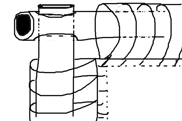

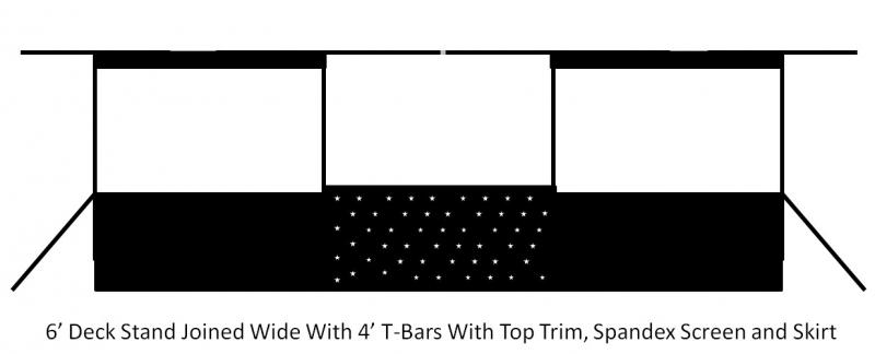

i think whatcha need is a seamstress. or a relative who an sew really REALLY good.
sewn continuous loops along the edges like a curtain rod would do the trick and then having fitted notches or holes cut in the ends of your framework so that they locked in place would prolly do the trick
and yeah i'm not a graphic design artist but this might get the idea across..
once it was set up it could be hung from ceiling or set in a stand almost anywhere without having to worry about droop or distortion from the surface - or errant breezes from ceiling fans or air conditioning as long as the stitching was a good straight line - would make a nice flat screen from corner to corner.

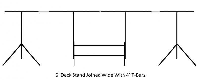

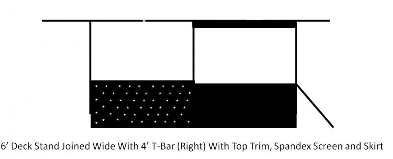

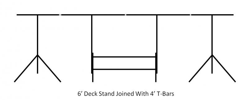

Thanks all for the comments... This is work in progress so I will continue to update as I make enhancements.
Should get my brackets today/tomorrow which will enable me to join all my t-bars together as shown below. This will give me a number of setup possibilities...
In this setup I would be creating an extra wide lighting rig
Here either an extra wide lighting or...
...support for two screens
then I can use any combination such is this one
All I am using is my Giraffe deck stand, the two Giraffe T-Bars, my starcloth and the Lycra.
 With Screen (Right).jpg)
