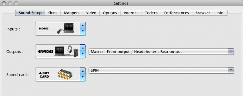

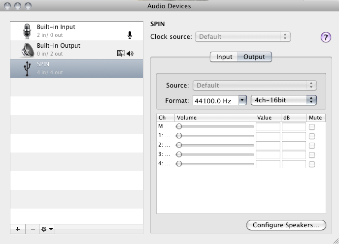

Which version of OS X are you using ?
With Snow Leopard (OS X 10.6.3), the SPIN appears as such in Applications > Utilities > Audio and MIDI Setup
Then in VDJ, setup as follow:

Hello th303 and Npozen,
If you play the sound on 2 different sound cards, for example the headphones on the Spin and the mix on the computer built-in sound card (which in my opinion is a mistake, it is safer to play all the sound on the same multi-channel sound card) you must check, in Applications > Utilities > Audio and MIDI Setup, that both the computer built-in sound card and the Spin sound card play at the same sampling rate (both at 44.1KHz), since if one is set on 48KHz while the other is set on 44.1KHz, the audio will be severely distorted.
