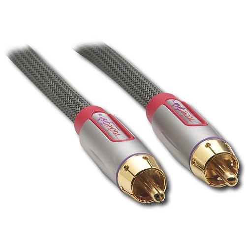

This is how your setup should be. The turntable outputs should be going to in1 (input 1 for the first) and the other turntable on input 2. The OUT1 (Output 1) from the scratchamp goes to the input channel 1 (LN1) of the mixer and the 2nd output (OUT2) of the scratch amp goes to the second input of the mixer (LN2). After that where you see the switches on top marked ph1 LN1 and ph2 LN2,ensure that they are both on the sides with the LN as shown in the picture below. Since you're using the Krk Rokit monitors just buy a double Rca cable and have it coming out from the Master output of behind the mixer to the Rca inputs of the Rokits left for 1 and Right for 2. In vdj go to config,sound setup, change the inputs to timecodes,soundcard to asio or scartchamp (depending on what pops up) and outputs to external mixer. Trust me you can't get it easier than this. You didn't say which Rokits you'rew using I assume it is 5.
