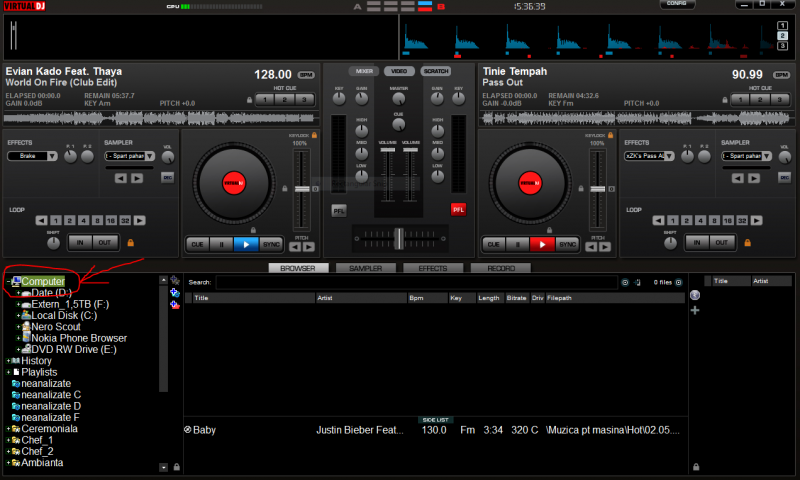

If I'm not wrong you have to expand the "my computer" in the folders window. Just click on "my computer" few times and the new drive will appear.

Tried that, the drive appeared but the database was not re-scanned!
