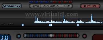

On your first issue there are a few reasons why the CBG (Computer Based Grid) may not appear correctly, however this is easily solved. Take this track for eaxmple:

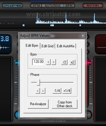

You can see the CBG is approx. half a beat out. If I right-click on the decks BPM button above the waveform, I get presented with the following dialog:

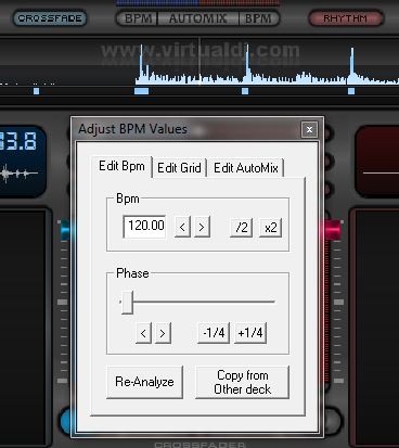

By moving the slider to the left, I can re-position the CBG and align the first (larger) block where I need it. As I have done here:
Once changed, the details are stored along with the track in the database and will now always align.
I do this on the fly - in other words when I first load the track. It's not worth doing in advance as you never know when or even if you will play the track...
You can also adjust this while the track is actually playing!
