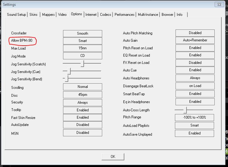

I would try to disable \'Allow BPM<80\' option.

Sorry but no luck there, had also tried it before and now i tried it again.
