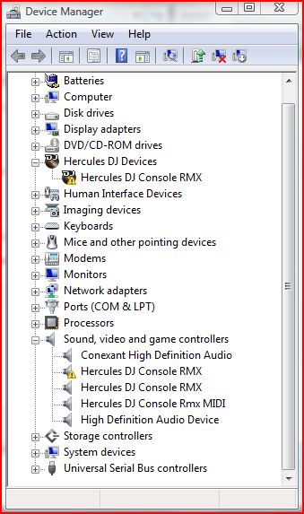

Okay. followed the vid step by step.. but what do i do with this damm (Found New Hardware) window ..
Again... it pops up ing the middle of the install.. chould this be the problem

And yes I did.. But. Even after I restart. It pops up.. I’ve tied selecting Don’t show this message but that doesn’t change anything in Device manager
Alright then. From this point in Device Manager, try the following:
Right-click on either of the DJ devices with the yellow !, and choose Update Drivers.
Next, select Browse my computer for driver software, then browse to the following path (where the driver files are copied):
C:\Program Files\Hercules\Audio\DJ Console Series\Drivers
Click Next
At this point, windows should indicated the compatible divers available. Obviously, select it and continu.
If this works, proceed to the next problematic device.
If it doesn't work, let us know what the error message is.

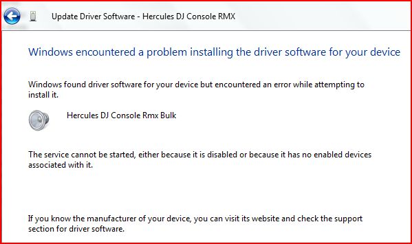

DJ Phatso wrote :
Alright then..
okay this is what popped up
