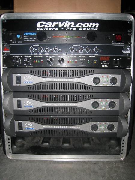

There are different ways to hook up subwoofers. I just keep it simple.. I am using two Jbl Mpro 418s subwoofers 600 watts rms & 2400 watts peak. It has a 135 db max spl. The subs are 4 ohms. I am using a QSC plx 3002 amp that pushes 900 watts per channel in 4 ohms regular. I am using a DBX 2/3 way crossover to separate my tops and subs. It sounds really good. My speakers push 400 watts rms in 8ohms so im using a QSC plx 2402. The 2402 pushes 425 watts rms in 8 ohms. I could use another amp that pushes alitlle more watts for the tops but it sounds good enough alrteady.
I wasnt talking about "hook ups".. :-)
I was saying that mixing and matching can add another layer of confusion for newbies. (just understanding RMX VS Program between manu. can be a pain in the arse)
arguement is mute anyways.. with the information you posted about your system, It probably does sound "nice", but could sound "holy crap awesome!",
but the only way to "prove it" would be for you to actually hear what your JBL subs can sound like in a system with properly matched amps and tops. (you didnt post what model of tops your using.. so maybe they are a good match? I do know your underpowering your subs, but again, might be a good match for the tops)

@ Hippy. The tops are Carvin Pm15. They are 400 watts rms, 800 watts peak. 100db spl. The JBL subwoofer can take alittle more from a more powerful amp more like 1,100 watts rms per channle but 900 watts sounds good. Before i had another qsc plx 2402 for the subs but i sold it to buy the 3002. I was lucky to buy the 3002 for 400 bucks.
The 2402 for the Tops & The 3002 for Subs.
