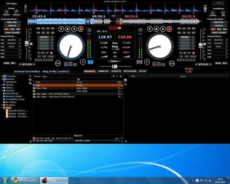

i have just upgraded from virtual dj 5.2 to virtual dj pro 6.. and i have noticed that the fat dots (squares)
are not in line with the beat.. i never had this problem with the older version..
Please help!

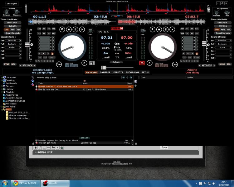

As you can see, the song on the left, in blue (J-Lo), the square's are aligned up under the beats. Where as on the right, in the red, the red squares are no where near aligned.

You see above, both songs have a square underneath the beat, and they match up lovely.
