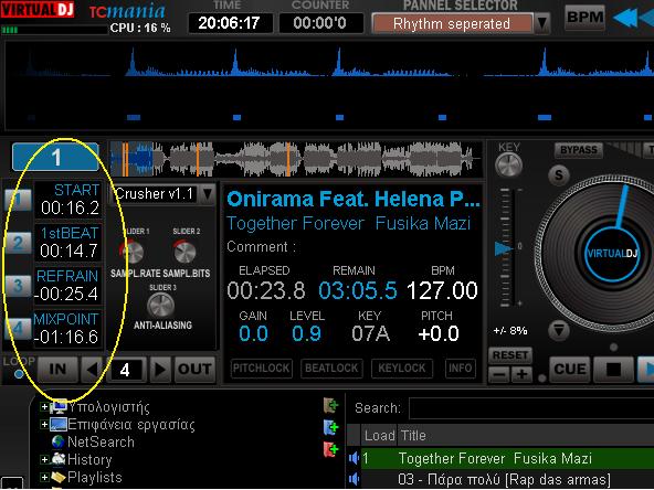

First, there is no way you can display the cuenames on the video screen (2nd monitor)
VDJ ver 7 (2 decks) 1280X800 skin does not display any cuanames next to the HotCues buttons. So you have to download a different skin, there are so many in the Download Area and the majority of them do support cue names.
The least you can do for the Skin you use is to enlarge the font size of the cuenames displayed in the wave form (rhtyhm)
This is the part of the xml file

I have marked for you, with bold letters, the fontsize which you should enlarge. Try size="16" and if you still need larger try 18 or 20.
In order to make these changes, you must unzip the zip skin file in a folder. Edit the xml file (with Notepad), save, then zip again and replace it back to the VirtualDJ/Skins Folder.

Hi DJDAD
Thanks a lot for the fast answers.
It´s a really great feeling to get help on this way. Like a family :-)
I rezised the Cue Names in the Skin how You recommended.
With size 22 its good to read and it´s very helpfully.
To be prepared for the next solo it would be better to see the cue names somewhere freezed.
The Hotcues-Windows have 2 Problems:
They are to small (my hot cue-names look like "Refrain2 Transp to D-Minor" or "Solo Trumpet c-d-e-g-f")
They are just 4 (I use 7 cues Intro, Str1, Ref1, Str2, Ref2, Solo, last Ref)
I would make a small Window in a skin but this is definetly to hard for me to do.
Many Thanks
Many Thanks
Posted Mon 25 Oct 10 @ 12:32 pm
I see. You certainely need a custom made skin for this job.
7 Hot cues.... hmmm i dont recall any skin with so many...anybody?
About the length of the cue_name, most of the skins (including mine) have scroll capability. Would that be helpful?
