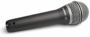

Hi made in Breizh, I had a busy schedule so too much work to answer on the forum, but in the meantime I have purchased for the RMX a Samson Q7 http://www.samsontech.com/products/productpage.cfm?prodID=1679 which is only 200Ω and the RMX loves it.
According to information from Google and DJ shops it is comparable to the SM58, although it costs much less.
