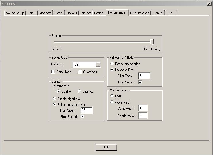

Can you try this settings?
This is from my Dell desktop and it works very good. But gives problems on laptops (distortion, slowing down).
I'm using Denon HC4500 (USB) and Presonus Firebox (Firewire) and I get about the same performance.
Posted Tue 29 Dec 09 @ 4:10 pm
It's the Spatialization setting thats doing it. 0 is designed for real time timestretching; anything above that is much much more taxing to use in real time.
