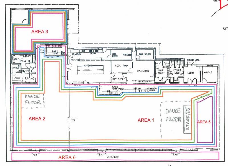

Thanks for the help so far! Here is a floor plan, at the moment I cant find measurements but 25 meter cabling from both dance floors should reach the amp/mixer to be placed near the middle of the bar, I might go 35m just to be sure...Is there a limit to Speakon cable length before the music output starts to degrade?
Speakers I have used for DJing the past 4 years have been the Quest QS500
Power Handling : 500W RMS 900W Peak / Maximum SPL : 126dB Nominal 12
I am looking at buying 4 of these..but maybe 500w isnt enough for Area1. Or if anyone has better speaker suggestions bring it on! Price is a little bit of an issue..the football club doesnt want to be cheap, but also doesnt want to spend a huge amount, so im thinking around $500-600 USD per speaker is about right for them.

Looking at the layout the QS500 would be neither one thing or the other. They are too small to fill the room on their own and oversized for working with bass bins. Area 1 would need 4 and area 2 would get away with 2. I would look into using a sligtly smaller unit like the QS350 and run them with a bass bin system. So 2X QS350 + 1 Bass bin in area 2 and 4XQS350 + 2 bass bins in area 1.
The Quest speakers you mention are also available as Active units (QSA) with built in power amplifiers. If you like the speakers you could go for the active version and not have to purchase additional power amps. With these, cable distance would not be a big issue but obviously you will need to budget for installing power points at each speaker location. Speker cable needs to get significantly heavier as distance increases so this can become a substantial cost issue.

The main reason for using additional speakers is to spread the sound evenly It avoids having too much volume in the stage area and not enough in the rest of the room. Active speakers are great for this as you can set each one for the volume you need in its area.
Most power amps will drive 4 loudspeakers with no problem at all. You are correct in that the additional speakers do add to the amplifier load but as long as the amplifier you chose is designed to do this it presents no problems.
If you were to go for the powered speaker solution I would suggest that you dont rely on the nearest power point but have a dedicated power ring installed to run the speakers. This can be done in a way that provides a convinient 1 switch power on/off to kill or activate all the speakers in 1 shot. I agree that you do not want power cables wandering arround where kids my be able to get at them. Thats a definate no no.
If we go for a sub/sat type layout then having satelite speakers with 15" drivers is a waste. The lower frequencey/bass that the slightly larger drivers would produce can be covered by bass bins and the 12" units in the smaller speakers will produce a clearer mid range. The the subs will be doing all the heavy stuff so you use lower powered units to do the mid and top frequency work.
