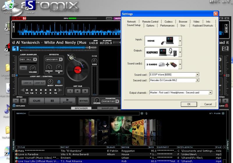

Hi dannyboy2005
I\'m using an mk2 controller my confg. setting in VDJ are set as per the image below.
You do hear the two decks through your headphones at first, this is what I did to fix it.
1. Find your headphone selector to switch between Split, Mix, Deck A & Deck B.
2. Start playing one deck, you should hear it through your headphones.
3. Now select a file on your browser, right click and choose preview.
4. Start switching back and forth the headphone selector knob till it clears the deck music.
5. You should only hear the preview song playing and not the deck music.
6. Select Mix so you get the sound through both left & right phones from the preview.
7. If you get Pop\'s and cracking noises, go to confg. Performances Tab.
8. Select Latency under \"Sound Card\" and set it to 2048.
9. Check the box Overclock, then click OK to save your settings.
Let me know if this works for you.
Joey....

The reason for having the second card is a matter of choice in sound quality, That's why the option is built in You're VDJ.
Yes playing out of RMX or MK2 is easier if you are happy with the sound, but if you're not then at least you have the option and for that I thank the VDJ team for Developing that added feature.
Just like controllers there are sound cards, so thumbs up for the variety of choices in VDJ software.
Joey....
Joey....

hi all
From the growing number of posts I have been reading on this the majority of people asking how is this done are uing desktop pc's and speaker systems. If this is what you want to do thats totaly fine but why buy the RMX? It was not designed to work this way so no one should be surprised when it causes problems trying.
Do your homework! make shure that the controller/whatever you get is going to do what you want.
BTW danny the method I suggested to you works but is a compromise. Its up to you because, as you see there are various ways of doing this.
Instead of trying to use the computers speakers (which lets face it are not always at the forefront of sound quality) how about looking at some of the superb powered nearfield monitors out there. plug em into the power supply and then into the RMX, how simple is that. Instead of all this messin about.
I don't think dannyboy is as interested in splitting hairs on the quality of sound cards as he is in just getting his setup to work at all.
Just some suggestions.
Daz
Daz
