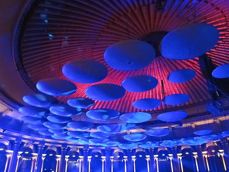

Another thing to consider is that you may not be ale to do anything with the sound system. You may need to introduce accoustic dampers/absorbers to fix the venue.
Here in the UK, the Royal Albert Hall is a huge venue but has a really great accoustics due to the accoustic diffusing discs in the ceiling.
