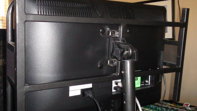

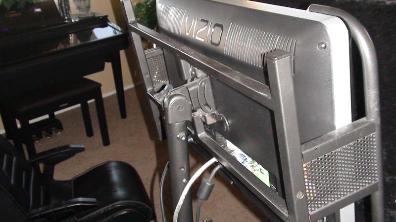

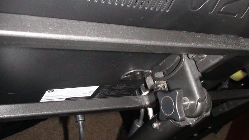

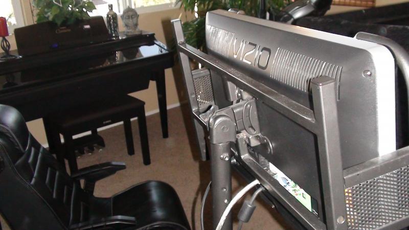

What I did was buy a wall mount kit at Home Depot. Then I took it apart and welded the screw plate to a bracket I made to attach to the pole of the stand. Then I painted the screw plate that I welded to the mounting bracket and it looks like I bought it that way.
Attach the mounting bracket with screw plate to the stand, bolt on the LCD and it looks beautiful!
Everyone asks me where I bought the LCD stand from.
Mine....

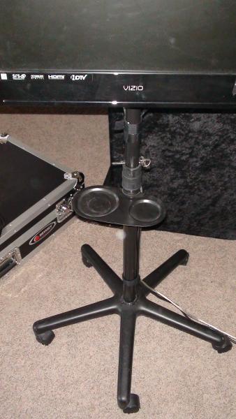

I got rid of the tripod legs and added this heavy-duty chair base and casters instead
This is how a fellow VDJ member (Kamakuakane) did his....
Mine....
DJ RuDe
Keep Spinnin'!!
