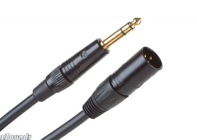

For your mixer, you are much better off to get yourself a good balanced cable output to yuor amps .. and especially if your running powered speakers you have to use Balanced cables or what some call (XLR CABLES) -- even though you dont have an actual xlr connection the connection on your mixer is the same it is called TRS tip ring sleve conection whic is same as an xlr , you can go to a music center or online and get a TRS to xlr to plug into your amplifier. I promise if you do so you will notice a difference in sound quality and def less hum
this is the cable you need most likely
