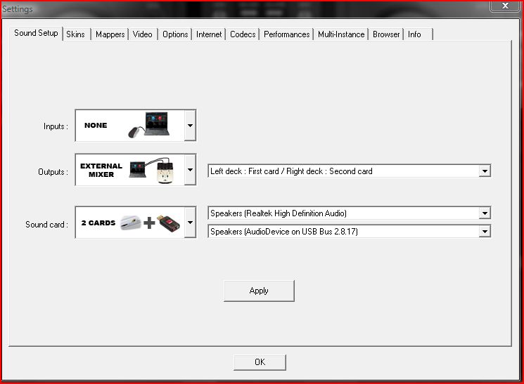

I just bought a Numark C1 on craigslist....I wanted this so I could easily use a mike.
I don't have external turntables, but I do have 2 sound cards.
Is there a way for me to have VDJ export deck A & Deck B over the 2 sound cards so I can use the crossfader, etc. on the mixer?

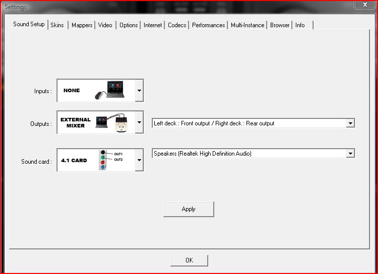

waht soundcards do you have.check to see if they have 2 outputs then you only need one to run vdj and use crossfader.if so then change youre settings to suit your soundcard

If one of you sound cards has at least 4.1 then you only need to use the one and set it up like this
If you dont have 4.1 (which is probaly unlikly nowadays) then you will have to use the 2 sound cards which you will then setup like this
Hope this helps.
