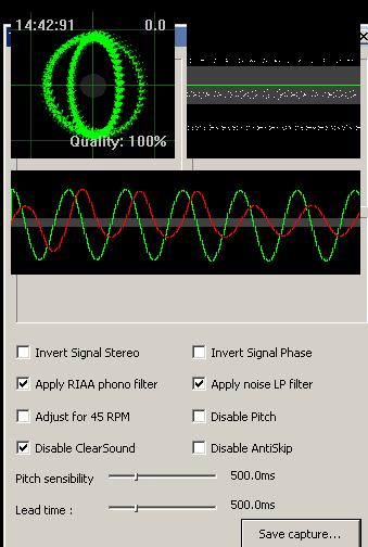

I am having issues with setting up my TCV and need help.
I am running VDJ v6.0.2 + VDJ TCV + Maya44 USB sound card. After a lot of toying with the settings, I finally get 100%, but that number often jitters.
In the manual, it says the "data stream - should show four dotted lines; two above the center green line and two below." In my setup, my dotted lines are all over the place.
Screen shot capture below.
Why doesn't my settings look anything like the setup in the manual? My circles are all ovalish and not clean circles.
Suggestions?
Suggestions?

i wouldnt go by this, when i first switched to tcvs i had a lot of issues with this feature, yet when it was playing everything sounded great...
Posted Sun 06 Sep 09 @ 11:15 pm
Mine have never read 100%. I still have good control.
Posted Mon 07 Sep 09 @ 12:09 am
I have fairly good control, but doesn't sound great when scratching. When hitting the stop button on the platter, the music cuts off abruptly, instead of smoothly like a normal vinyl.
Posted Mon 07 Sep 09 @ 12:34 pm
Check the Connection of your needles. The time code record could be worn out (Flip over)
Posted Mon 07 Sep 09 @ 5:14 pm
my system fluctuates from 70-100 percent on both sides, yet it never goes out of whack and this has been going on for the last few releases.
I also had a crappy sounding scratching and if i would stop the TT then it would slow down, skip & hiccup, so i did a factory reset and has worked well since.
