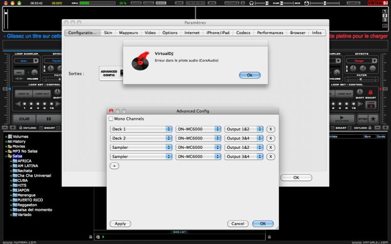

If you are using VirtualDJ in Outputs: External Mixer mode, then try raising the volume of the other deck (The one that's not playing out live) to increase the volume of the samples.
just is that I advocate in my tutorial mode advanced audio!
Why we need to put this:
Deck 1 : DN-MC6000 ---> Output 1&2
Deck 2 : DN-MC6000 ---> Output 3&4
Sampler : DN-MC6000 ---> Output 1&2
Sampler : DN-MC6000 ---> Output 3&4
Yan
Posted Thu 09 Jun 11 @ 2:35 pm
VDJ 7.04 and Mac 10.6.7 doesn\\\'t accept such a advanced config
Raising the others fader doesn\'t increase the sample...........
