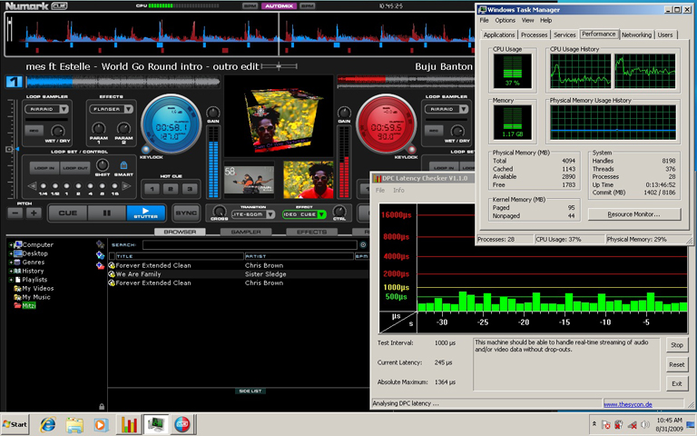

so nooooo one has any ideas? well good thing i had windows 7 64 bit laying around. i jumped on microsoft and grabbed a new Key for my RC copy and BAMM! Cue 5.2 has been running in automation all night dpc latency checker never got over 730 in almost 8 hours of automixing. i no longer have the video freeze issue nore do i have ANY sound issues. if your having problems try an install of WINDOWS 7 it simply JUST WORKS! i can not wait till the official release. they aren't kidding when they say 7 is what vista should have been.

i have had it in automix since yest am with cube, rotation, scroll text, show logo and playing deck b when i think to hit space bar and it hasn\'t hicuped once! i even updated some things online while its been running with no issues. ram hasn\'t hit over 1.6 gb even when doing the most at once. latency checker stays low etc. i have been runnign 7 on my AV editing tower for a monthish and its great.
