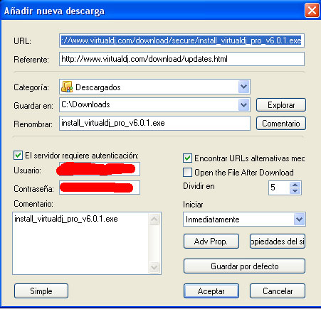

The best solution i can think about is... use a download manager... something like flashget... I just made a test with the flashget download manager and it works... just put your username and pass on the flashget option & thats it.. you will download the file with no errors.
Best Regards!!!

Im using Firefox, & flashget, i can resume the download fromatomix with flashget because i put my user a password in the flasget option, also using my cellphone as a modem... i think you really have serious problem with your conection,...but i got a question for you... after a couple of weeks you did not have the chance yet to go to a place with decent internet conection ? , are you in the middle of nowhere in Antartica ?
Try again with firefox and the flashgot plugin for Flashget, i have to say that using my cellphone as a modem give a slower conection than dial up. & it works perfectly...

Did you tried with the flashget and the settings i told you before ?

Ok ive downloaded flashget
Flashget Version 1.9.6.1073 ...... ok found settings under advanced tab
URL https://virtualdj.com/addons/download/pc/8802/Dex_Vdj_FX%20beta%201.exe
Comment
Referer https://virtualdj.com/addons/8802/Vdj_Dex_.html
Resume No
Local File C:\Documents and Settings\Dave\Desktop\flashget downloads\Dex_Vdj_FX beta 1.exe
File Date
File Size
Completed 11.59 KB
Total Time
Average Speed
Create Time 08/09/09 21:39:31
Complete Time 08/09/09 21:52:44

Don't use FlashGet or any download managers when you want to download on the VirtualDJ website as they can't well handle the website security.
