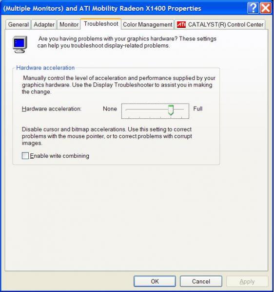

OMG! I think I figured out my popping/crackling problem. It was the video card on my Inspirion 9400 (ATI Radeon). I opened the properties for the video card (right-click desktop, click Properties, select Troubleshoot tab) and moved Hardware Acceleration one click down.
The popping is gone regardless of what skin I use! It's party time!
Robert
Robert
