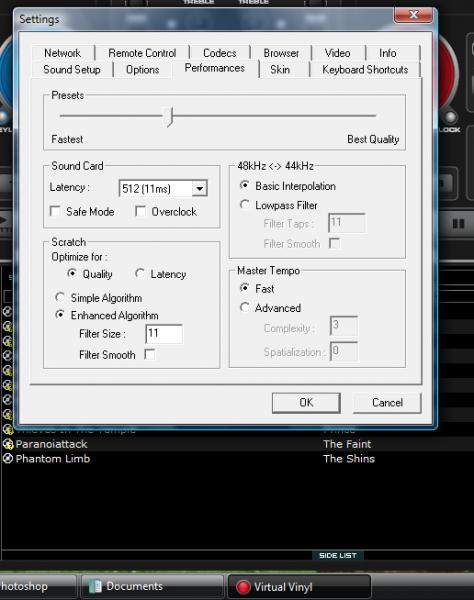

As a last ditch effort to eliminate usb audio dropouts with the Audio 4 soundcard I have....I\'d like to try to see if I can use a PCMCIA USB Audio adapter rather than the normal usb ports on my laptop.
I keep getting an something that says \"error in asio driver\"
Does anyone know if it is possible to run this soundcard through a cardbus usb adapter? Those idiots won\'t help me because I\'m using VDJ. Fuckers.
Does anyone have any good ideas toward getting rid of these embarrassing usb dropouts?
Here are my settings.

Set the Preset slider to Fastest
Put Latency on Auto (from the drop down)
