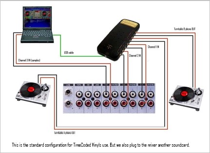

I got a DJM-500 and 2xCDJ-100s that I'd like to try out using Virtual DJ, but I can't seem to find any schematics or guides on how to hook all this up to my computer for use with Virtual DJ.
So the question(s) are: Is it doable with the DJM-500 alone or do I need a midi-controller? And if doable without a midi-controller, could you please write a short summary on how to do it?
Any helpful inputs are appreciated.

First of all you need an external soundcard for timecoding.
Without that soundcard, you can't use VDJ with your sound system.

In regards of the external soundcard, I believe you're trying to tell me that I'm just in need of two soundcards on my system for this to work?
If I go through with this, I'm most likely to build my own flight and incorporate a computer I got spare into the flight. Would a PCI-card do just the same?
What spesific inputs is it that the soundcard is required to have? 1 line-in or do I need more?

You need a multichannel soundcard like AUDIO 4 DJ, AUDIO 8 DJ, MAYA 44 USB, etc.
You can look for any information about these, on the web.
It's the same if you want to hook your turntubles up.
