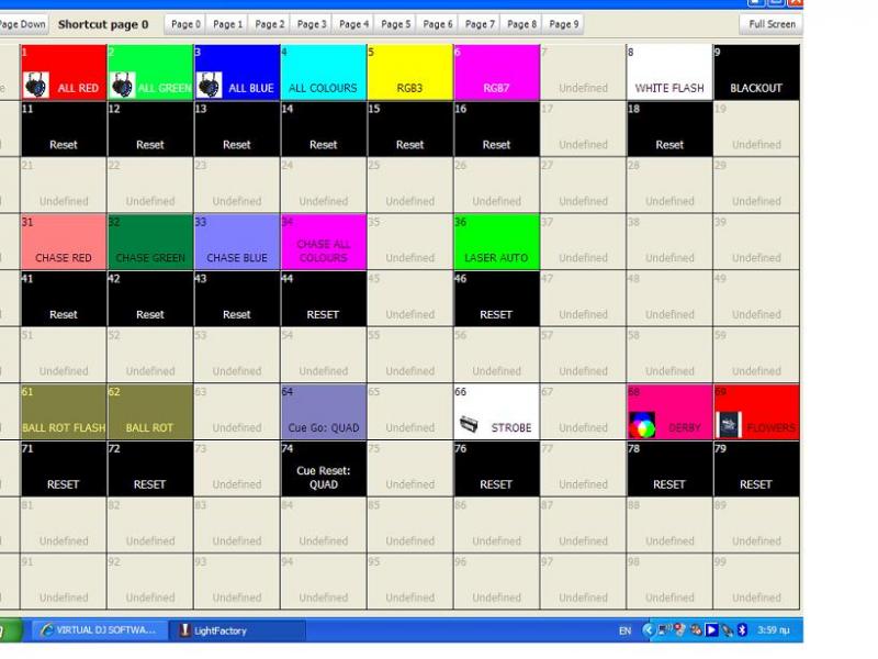

Katarxin oson afora tin syndesi... Kremas ta fwta sou stin mpara. Kremas episis kapou konta kai ton DMX SwitchPack. Se auto tha syndeseis ta fwta pou den einai DMX me kalwdio reumatos (4 theseis). Etsi kathe kanali (chanel) tha einai kai ena fws (on-off). Meta sundeeis ta kalwdia DMX se seira (mpainei vgainei), to opoio apo to teleutaio kataligei stin konsola DMX. Ousiastika oli i kalwdiwsi ginetai konta sta fwta kai apo ta fwta mexri tin konsola DMX paei mono ena kalwdio DMX.
Etsi apo tin konsola exeis ton pliri xeirismo, anoikse kleise, ftiaxneis skines, programmatakia kai me to patima enos koumpiou kanei auto pou tou exeis pei. Oi diakoptes pou xrisimopoieis den einai kai toso euxristoi, Tous eixa kai kserw.
Vevaia tin konsola den tin xrisimopiws pia, paizw ta fwta mesw deuterou laptop, USB interface kai software Lighthfactory. Pare mia idea gia na se ftikasw.
Posted Thu 19 Feb 09 @ 8:02 pm

Loipon katarxin mporw na sou poulisw tin DMX Konsola (akrivws idia) kai tin balitsa metaforas (exw bebaia tin megalyteri) http://www.thomann.de/gr/thon_19_koffer_8_he.htm (Paketo 140euros)
Allwste xrisimopoiw twra opws sou eipa laptop kai software.
Pairneis to switchpack, ena megalo kalwdio DMX (mikrofwnou) kai merika patch (Osa DMX fwta exeis+auto gia to switchpack, kai afaireis ena (1). Dld an exeis dyo DMX fwta kai to switchpack, xreiazesai 2 patch kalwdia (1,5m i 0,90m,0,5m analoga))
Oson afora gia tous Par56 Led to djshop se epiase koroido, koita o thomann poso tous exei (exw 4 apo dautous) http://www.thomann.de/gr/stairville_led_par_56_alu_poliert.htm
Pairneis auta kai meta sou kanw oso seminario theleis.
Posted Sun 22 Feb 09 @ 7:53 pm

Loipon katarxin djdad kai pali fysika se eyxaristo , an kai mono ena eyxaristo gia mena , den arkei gia tin boitheia sou , opote epifilasomai.....
Tora oso gi'ayta pou poulas esy , se eyxaristo gia tin protasi sou , alla panta agorazo me karta kai oxi me metrita , kai epofeloumai opou yparxoun (an yparxoun den me noiazei) kai kapoies atokes doseis.Opote tha agoraso pali etsi.
Episis to switcpack exei 4 theseis gia prizes , pou simainei oti ama ego exo 6 fotistika , sta alla 2 apo pou tous dino reyma?
Ektos ki an sta epipleon 2 fotistika , mporo na doso reyma apo ekei pou tha einai stimena , gia na min travao kalodia.
Ennoitai omos an katalava sosta , oti ayta ta epipleon 2 fotistika , poy den tha paroun reyma apo to switchpack , oti tha prepei na einai dmx.
Diladi vazo sto switchpack oposdipote!!!! ta 2 fota pou den einai dmx , vazo kai ta alla 2 pou einai dmx , kai dino reyma sta teleytaia 2 dmx apo ekei poy einai stimena.
Kai ola pleon afoy tha einai sto switchpack ta leitourgo apo tin konsola , akomi ki ayta pou den einai dmx.SOSTA?
Ta rotao ayta , gia na do an katalava sosta , prin ta agoraso , kai an einai etsi , tote na proxoriso stin agora.
Katarxin loipon agorazo , 1) to switchpack , 2) tin konsola , 3) to racks metaforas tis konsolas , 4) kalodio polla metra apo to switchpack stin konsola , 5) kalodio peripou 1,5 metro apo to teleytaio fotistiko dmx sto switchpack & 6) 3 pio mikra kalodia gia tin sindesi ton 4 fotistikon dmx metaksi tous.
Ayta pou leo einai sosta?Ayta na agoraso loipon ksekinontas?
Kai leo gia ta epipleon 2 dmx fotistika na agoraso ayta telika pou les ki esy.
Ta eida kai se diafora video kai pragmati einai kala gi'ayto pou ta thelo.>>>http://www.thomann.de/gr/american_dj_revo_sweep.htm
Posted Mon 23 Feb 09 @ 3:59 am
