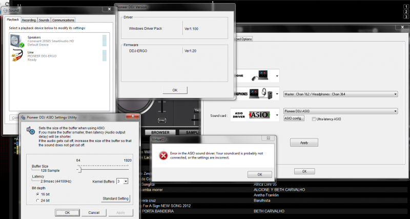

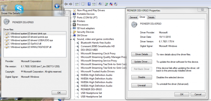

Hi All, I just bought DDJ Ergo and I\\\\\\\'m unnable to use it. Here is a screenshoot with the compilation of error message and settings. I\\\\\\\'m at Win7 (64bits).
I already uninstalled and re-installed everything, nothing works.
Device Manager shows at driver details that they are using windows drivers not Pioneer ones. How Can I proceed?
I have a gig tomorrow and I\\\\\\\'m looking forward to use this controller. What can I do?
Please help.
Please help.
